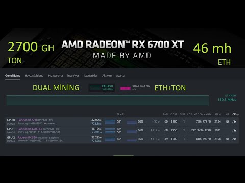

Teamredminer 46.47 mh 66Watt
Eth Ton Lol miner 1.43 Ton pool
very good consumption. I also tried similar Oc settings, but 77 watts did not go down. Can you share detailed OC settings?
Tried those same OC settings fro my 6700XT Sapphire, but after a few minutes farm goes offline…
Using
Core VDD/VDDCI/MVDD MEM
1900 780/660/1060 1260
With nbminer (nothing dual yet).

I use 1350 1 675/675/1250 1074 for eth/ton
I have tried higher core clocks, but depends on the algo and card
Lolminer 1.43 tonpool 46 mh 1334gh 114 watt
Eth Teamredminer
Soc vddmax 804 mv
Lol miner 1.43 tonpool com
Xfx qick 6700xt 45.5 mh 1360-70 gh ton
Socvdd 804

Eth + Toncoin overclock ayarlarım.
Teamredminer ver 0.9.3
Gpu 2 socvdd 940 , diğerleri 0
xfx Rx6700xt 46.4 mh 65watt teamredminer

xfx 6700xt 46mh 2700mh eth ton
