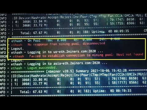

Do u recommend any other pool settings meanwhile?
For now its horrible as per this shot
