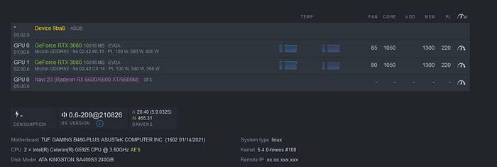

RX 6600XT ETH / ERGO / BEAM with lolMiner | by J | Aug, 2021 | Medium
We are going to try today a RX6600XT thanks to #Jumper for the GPU to do the test.
We are going to test it in a Mix Rig in HiveOS.
Mix Rig

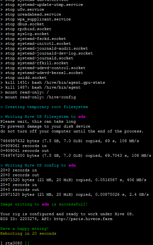

That will never work, because we have an old version of HiveOS, so we decided to create a Hive Shell and do:
hive-replace --list
After that we select the last stable image writting 1 and later writing yes
Update of HiveOS done
Then it will automatic restart and now we have HiveOS 5.4.0-hiveos #140

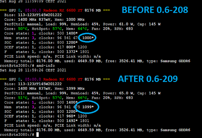

We can see now perfectly the temps of memory and Watts. Let’s start to configure it, and we found the first problem:
Needs to be updated minimum to 0.6–209
After that update we will be able to go up in memory more than 1075.

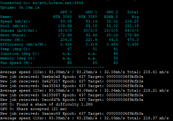

Now Memory Pick 1100
With 1000 in Memory we have 28.4Mhs
With 1100 in Memory we have 31.2Mhs
With 1150 in Memory we have 28Mhs it goes down let’s try to find our max, reducing and finding the value between 1100 and 1150.
After testing we see that if we increase to much the Memory the vaule deacrese, for our card the best value is 1130 -1132 where we are in 32Mhs.
So now we have 32Mhs at 65W, let’s try to reduce that Watts, after several modification we are able to get less than 50W
32Mhs at 49W
Really an interesting GPU to play, temperatures of the card are incredible good.
The results for Beam: Core 2000 / Memory 1050 = 15–17sol.
At the moment not ERGO miners ready, we will update when they are able to mine with 6600XT
