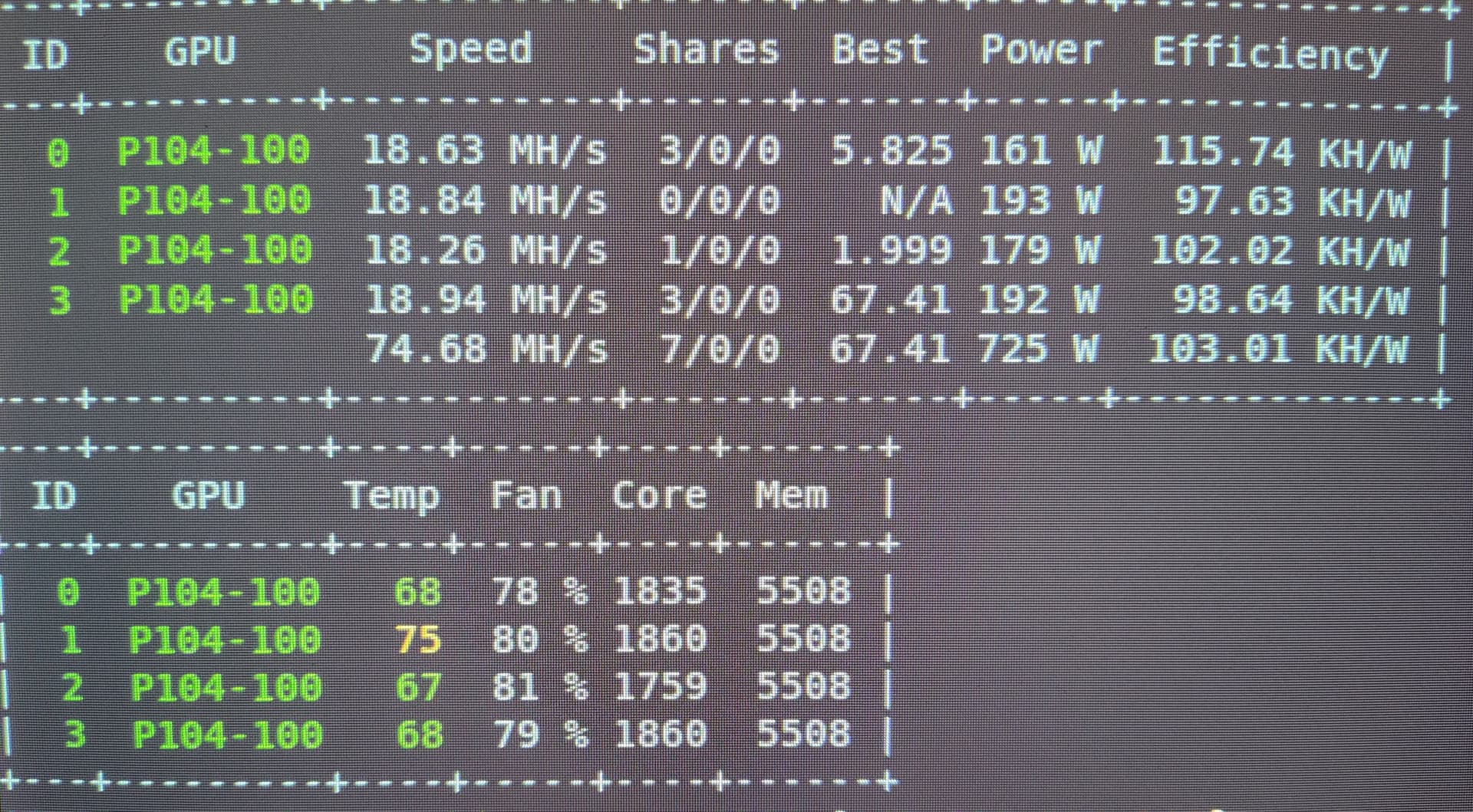

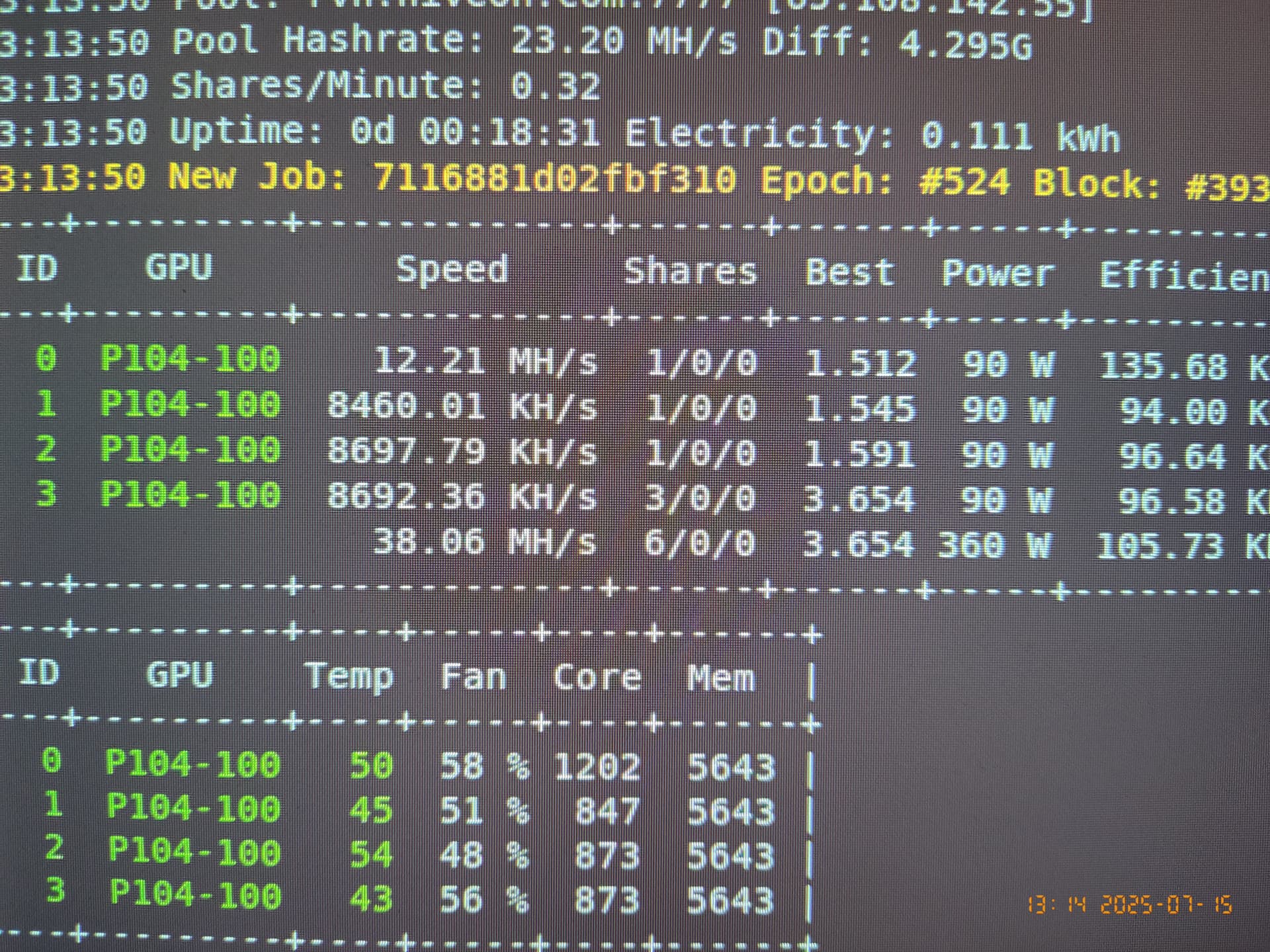

Try running a single gpu at a time and getting it to work as you want, then add one more and so on. also, keep in mind you dont need xserver to mine, especially headless, though you may have nvidia oc issues if xserver isnt functioning properly.
SLI 0, 1 & 2 way sli
cardinality
2 Evga ~225 core 1005 mem
3 Gamax 1-way sli ~
0 Gamax 2-way sli ~12 Mhs/s
1 Gamax 1-way sli~
