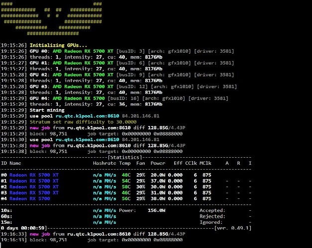

The issue is this: when you launch the miner on QHASH—regardless of the pool—it connects and seems to be running, but no hashrate is registered.
What all does the miner log show?
It connects and seems like it should be working, but there’s no hashrate. This is happening on all the rigs; I’ve tried different pools and regions.
I’ve already tried everything; other miners work fine. What could the problem be?

A week ago, everything was working as it should. I tried installing Windows on the rig, and it works fine. I have six rigs with different cards, and all of them stopped working on HiveOS.
I checked the statistics; they all disconnected on July 9th at 3:00 AM Moscow time.
