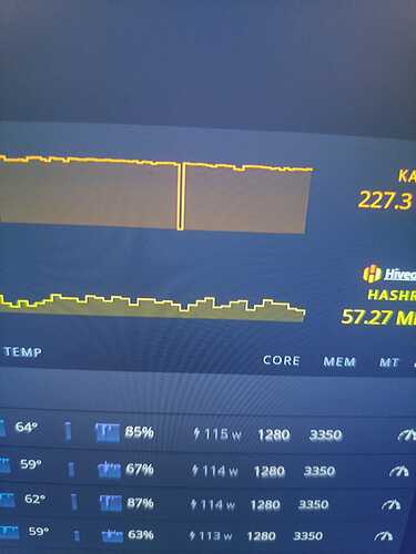

The day before yesterday, I noticed that in some places on the Have pool, the hashrate is 3-4-5 times lower than what the rigs are actually producing.
It randomly increases and stays that way, but if you restart the miner, you’re back to catching shares under the baseboard. But generally, everything is bad or very bad.

A few examples. This is after just a few hours of work:
Hashrate: 290.37 MH/s, Shares/min: 4.795 (Avg. 3.448), Avg.P: 962W, Avg.E: 302kH/W

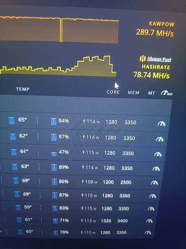

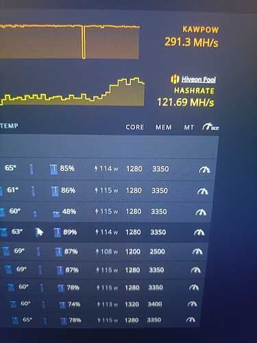

The average would have been better if the pool hashrate hadn’t dropped earlier (photos 2 and 3).

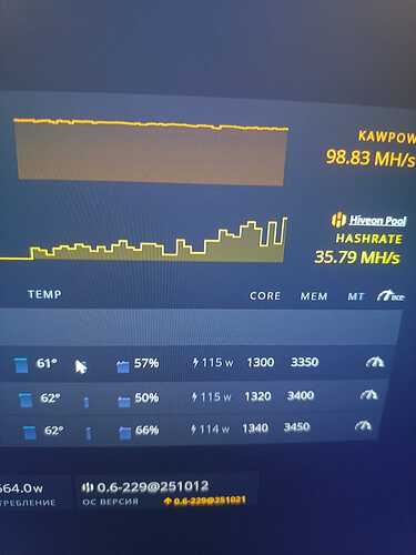

I restarted the miner, and the pool hashrate dropped, the shares deflated to an obscene degree (photo 4):
Hashrate: 285.94 MH/s, Shares/min: 1.411 (Avg. 1.177), Avg.P: 1015W, Avg.E: 282kH/W
Max diff share was found by GPU #1, diff: 146.01 G
Uptime: 38 mins 30 secs | Algo: kawpow | Driver: 550.144.03 | T-Rex 0.26.8
The first photo reflects the overall picture across all rigs, 90% of the time over the last 2-3 days.
