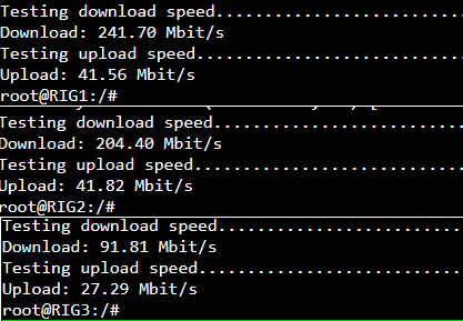

ok I figured out how to install the okala speedtest
all three of my machines are same motherboard and same CPU
Rig 3 is way under speed

check to see if its set to 100Mbps, in practice youll see it limited right in that 89-92-Mbps if not set to 1Gbps
would that be done in the BIOS setup or in HiveOS
Check to see what its set at first, but could be set either from the router/switch/cable or bios
so all three machines plug into a router directly and all three ports are identical so I will check the bios
try swapping cables/ports etc and run tests each step to rule any one single component out
