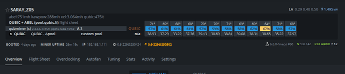

I can see the hashrate information while mining Qubic.
I am mining another coin (ABEL, QUAI etc.) while idle (not mining Qubic).
I cant see the hashrate information. The previous hashrate information is shown.

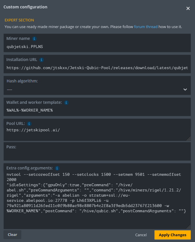

Flightsheet:
The rig has abel.sh and qubic.sh for overclocking.
There is no problem. The rig choose the correct overclocking setting acording to mining coin.
I use Rigel Miner for ABEL mining.

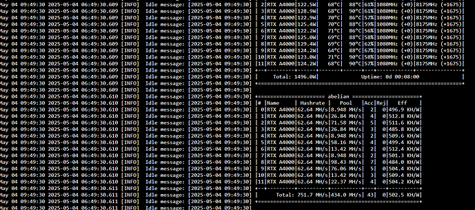

Now, it is idle mining. The rig mining ABEL. The hashrates for Qubic but Qubic mining over.
I want to see ABEL mining hashrates because Rigel Miner mining ABEL right now.

ABEL Mining:
is it possible ?
you would need to request that from the person who made the custom miner you are using, hive will show the stats that the miner passes on to hive, they currently dont have it configured to show any stats for the idle mining.
Thanks for the informations. I will contact the developer of the miner.
