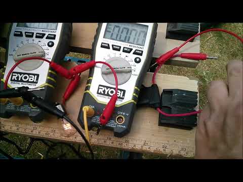

This is a simple example of what happens when there is an unbalance somewhere
