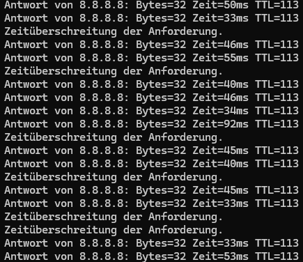

Rejected Ratio of GPUs
Is it conceivable that a poor internet connection leads to a higher rejected share ratio?
more likely overclock or pool/server itself. if the algo is supported on another miner you can try that as well.

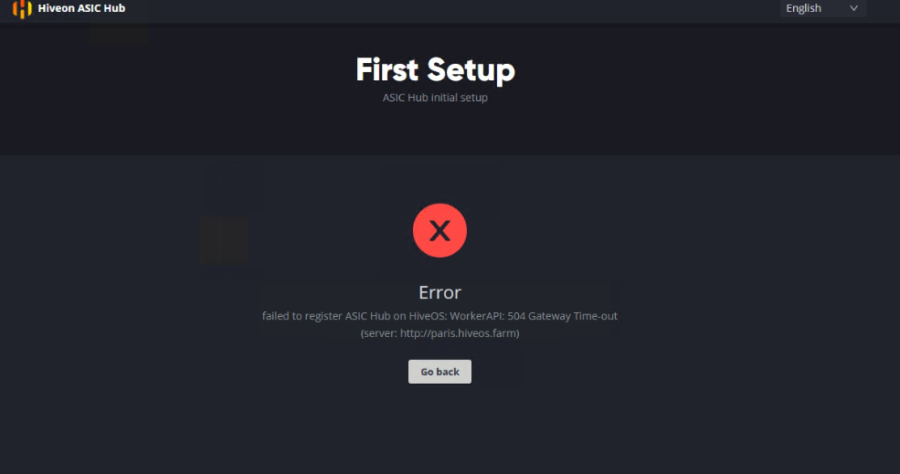

Hi is there any issue with hiveos? stats ar not worling anymore
There was an issue earlier with he default api server, if your rigs are showing offline you may need to change the mirror url in the menu to api.hiveos.farm and set
Error
failed to register ASIC Hub on HiveOS: WorkerAPI: 504 Gateway Time-out (server: http://api.hiveos.farm)
I did reset my rig monitor and now i get this .
sending device hello request
monitor

I have also massive Problems to get my Rig Online and Running, but my probs maybe differ than these, dont know…
That message usually means the rig never synced time correctly
or lost network during boot.
A few quick checks:
– does the rig get an IP via LAN?
– is NTP enabled / correct timezone set?
– BIOS: CSM disabled, Above 4G decoding enabled
– does the rig apear online in HiveOS dashboard at all?
If you want, post:
– motherboard
– GPU count/type
– LAN or WiFi
– does it boot consistently or randomly fail
Then we can narrow it down.
