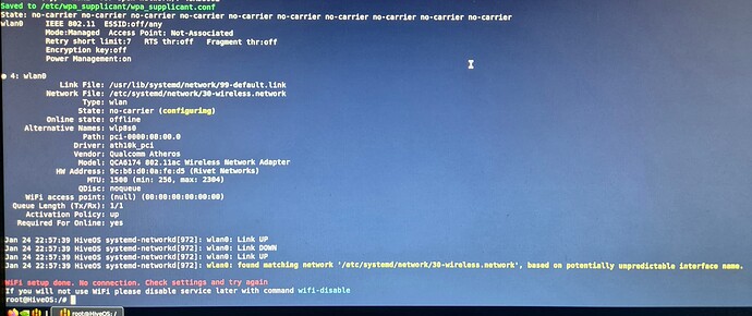

I did what you said and its still acting up. Windows and Linux Mint has no issues connecting to the network and has a strong connection, HiveOS however refuses to cooperate. This is all I get, is there a driver issue?
which image/kernel are you on?
if you reboot after setting the wifi credentials does it connect at all?
It does not connect after reboot.
what kernel?
