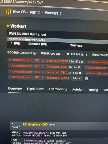

Hello everyone,
I have two 5600 XT And one RX 580 and they were mining since two years on the same set up without upgrading the system or the miner. I encountered a problem in which, after setting the watch dogs, my leg was still fail to initiate automatically because it was not mining and every time I need to do a manual restart and the rig is good for a few hours.
I thought it’s an update problem and I upgraded the Hive OS to the latest version since then I am encountering this error, you can see in the screenshot.
I have tried different miners and all failed to initiate with some different errors respectively. I am using teamredminer since a long time And since nothing else had worked I’m still using this miner. I downgraded to many miner versions but the error is still the same. Currently testing on a 0.9.2
The coin I am mining is RVN. I don’t have the exact error log with me, but I will share in a few minutes under this post.
You can try installing some older amd drivers via amd-ocl-install 20.40 or flash an older stable image with the older drivers installed hive-replace --list then choose the one that says kernel 5.15 #110
The driver you suggested, whether upgrading or downgrading, didn’t resolve the issue. However, downgrading Hive OS worked perfectly. it’s mining now. Thanks for your help!
This is the first time my rig is working since several days continuously without any problems or restart. You’re the expert, thank you for suggesting me the super stable hiveos version!
Glad to hear
=== Last 50 lines of /var/log/miner/teamredminer/teamredminer.log ===

When this happens a miner does not work automatically and it always require a manual restart can we find a reason to that?
Whenever you get a crash like this, its usually due to too aggressive OC/voltage
I’m not a voltage expert and I don’t know what to modify but I will give it a try modifying.
What settings are you running now?
What did you downgrade to? I’m having same problem. 4 580s and a 480 won’t work after updating.
see comment above in this thread: New weird Error on RX 580 8GB - #2 by keaton_hiveon
Thanks. I did that. Now no dead gpu but showing amd oc failed and won’t start. Just upgraded all the way to newest and it picked up all my cards. Last version I was on was like 206 I think.
post some screenshots of your config and miner log
miner stopped and cant get shell.
when it is showing offline you wont be able to do anything, check the rig and make sure its online/not crashed
So I downgraded right before that pic and it won’t start now. I have a wifi adapter and I’m thinking when it downgraded it cleared the wifi i set up. I’m gonna mess with it again later today.
so thats why i was offline because that update erased wifi. i reset it and went back online with 6 gpus. Then plugged in the last 2 and wont mine. So ill do them 1 by 1 and see.
try flashing the older image with the older kernel/driver(no need to touch driver after hive-replace) instead of just the driver
Got it up. So far fo good. Thanks for the help. So now that its running can i run logs and if it crashes it will show me what happened?
