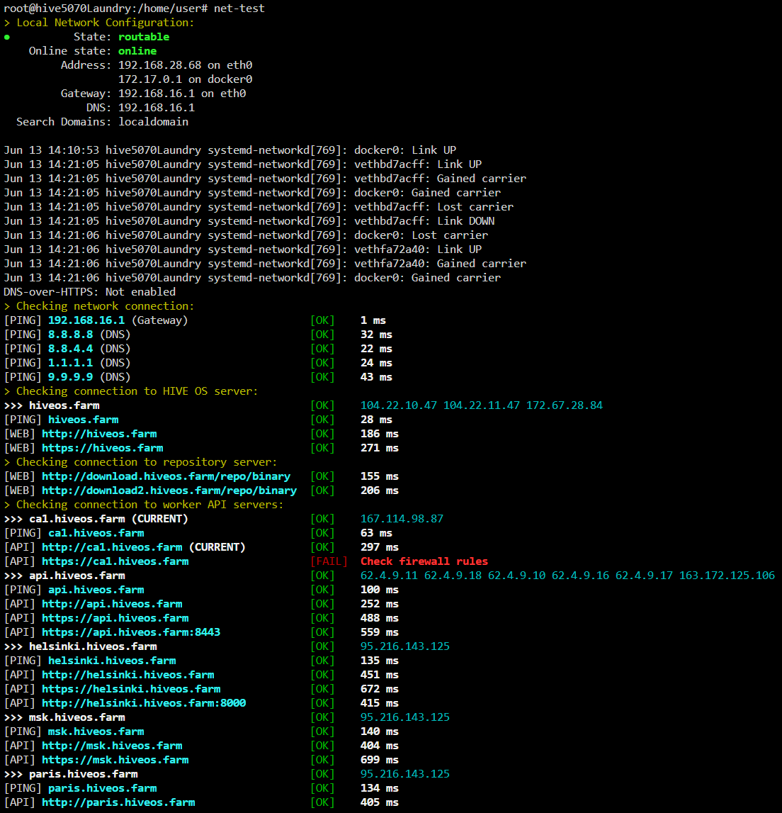

It’s possible your isp/router is blocking the needed apis. Please run net-test from the machine while it is showing offline, and post the results here
can you guide how to run net-test

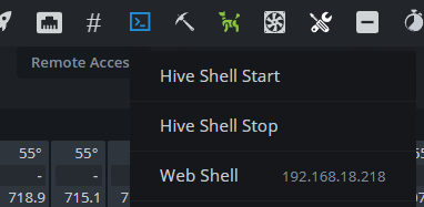

if youre on the same network, you can go to the ip address:4200, or click on the ip on the dashboard, or remote access menu → web shell
login with default username / password of user / 1
then type net-test

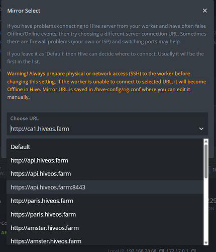

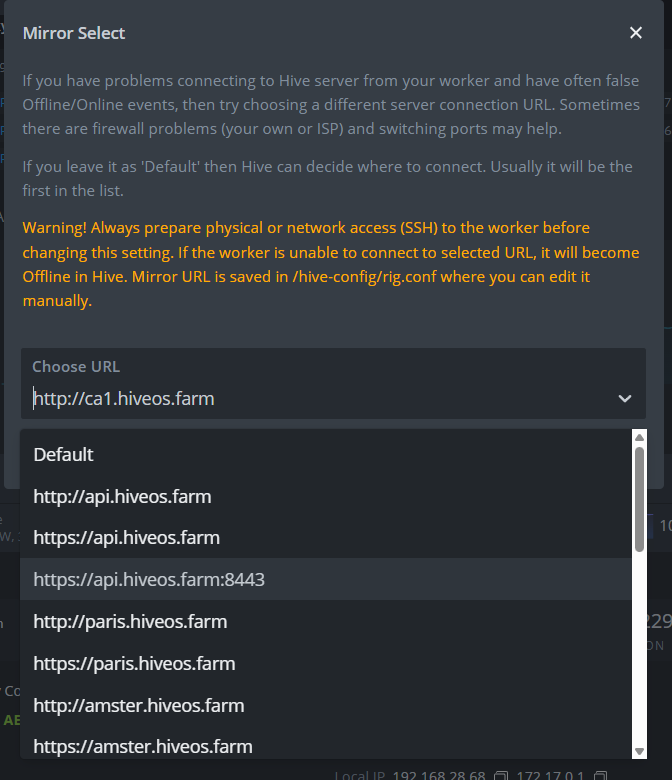

if any of the current apis are showing offline, you can switch to one that is online under the mirror url section
then set and reboot if needed.
