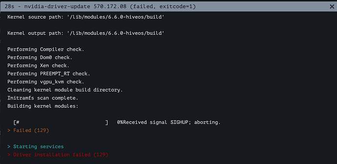

Hello, I’m having trouble updating from the 550 driver on an RTX 5060 Ti. Every time I try to install a newer driver version, I get the following error:
try enabling maintenance mode (without loading drivers) from worker options menu → reboot
install driver, wait for success message (may be best to run from shell instead of run command box so you can see live output)
disable maintenance mode and reboot

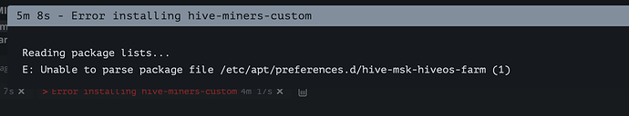

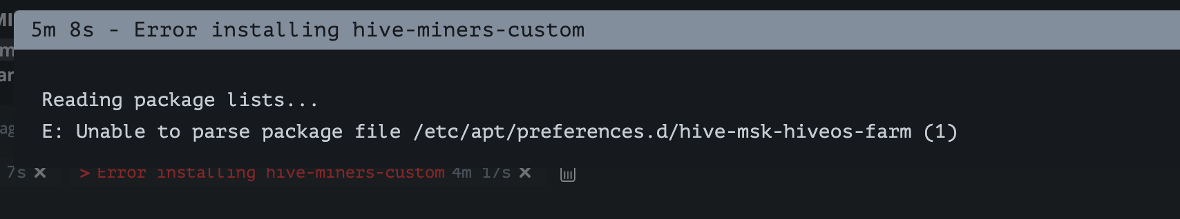

Hi! I managed to fix the previous issue, but now I’m running into another one. Do you know how I can fix this?
Try running selfupgrade, if it still errors try changing the repo in worker settings to download2 and try again
