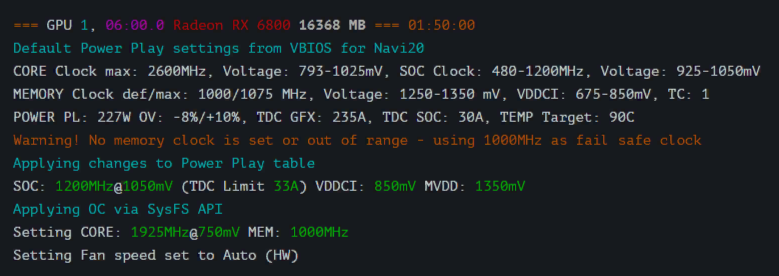

My settings**:
** there also applied voltage offset patch for core -75mV without it will be ~800mV or so, but for sure lower than yours
Sapphire Nitro
rx6800_info
At first view undervolting works fine…

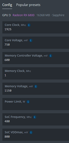

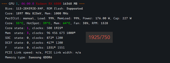

I prefer efficiency instead hashrate. In my case 1925@750 much better than 2000@800
Anyway, what voltage offset patch are you using?
Why might undervolting at 2000@800 not work for me? How do you think?
Try 1925@750 … What power consumption, real core clock, core voltage will be with this values?

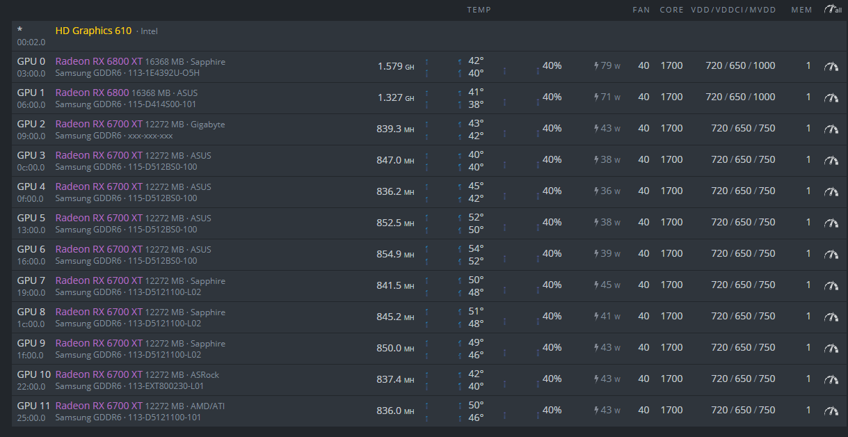

I have MIXED rig (rx6800+rx580)
So, HiveOS has problem with undervolting RX6800 in mixed rigs, for example RX6800+RX580, on higher core frequencies (CC>1800 MHz). Can developers or support explain this BUG in HiveOS?
