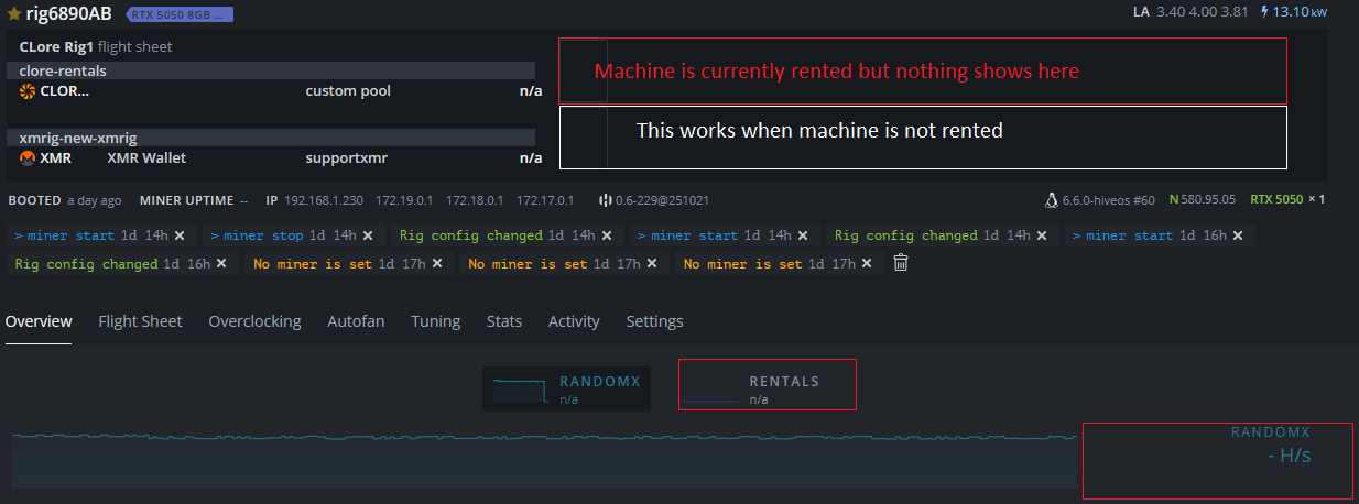

I originally connected my servers to Clore.Ai using the long method. Found this created issues and submitted a ticket on it. I resolved the hive os issue by reinstalling HiveOS. Then I saw where a new method was issued by HiveOS so I used that method. There is an issue, when not rented the status shows the system your mining correctly, however when someone rents your machine the rental stats do not show
In here nothing work, when i select a flightsheet for Clore Rental , it try to update linux and fail
have you tried a fresh hiveos install?
Yea every thing works it is just that when it is rented, either server, nothing shows just the NA
on the Clore Rental, but when it is mining the information does show for the XMR
