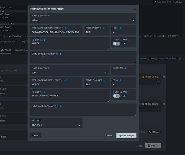

hive makes it easy to fill in pre configured boxes TRM:
lolminer:
Right i know what you are sayng. But i am using this pool for ton https://ton-pool.com/ and few days ago the miners was submiting shared but they changed the stratun. and when i was enquiry over telegram they told me to do this settings.
Funny thing. On lol miner i can see he have predefined commands like : Deviced Nvidia or Devices(folowed by a number to specify). the easiest one will be Devices Nvidia…but he uis tryngto oposite…lol
Managed to make lolminer work , but on TRM i cant start the ton
Hey Keaton can you share configuration for the ton pool? (what url are u using)
im using the same pool, just placed it in the pool address section to simplify things, let the features hive offers make things easier
for TRM and i am using exactly your settings in the miner apart that i am on EU. Lol miner worked
Trm needs the port as well
And where to find that? I mean is same like yours? 443?
You’re using the same pool right? Port should be the same.
Keaton love you forever :slight_smile:

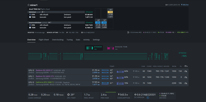

Now i have like 600 mh less on TON , but i will call it a win as i am pulling almost 200w less from the wall and lest temps on the amd cards. I am pretty sure the MSI can do much better but i will try it in another day as i have like 3 h from when i try this and i got bored :slight_smile:
Good stuff. Also, a recommendation for the nvidia card, don’t use a power limit, and instead, use the core clock to limit power draw to where you want it to be. Running a high core clock and a power limit that ends up making the card throttle itself is counterintuitive.
