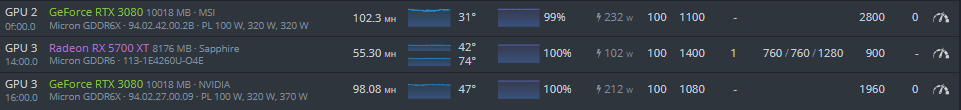

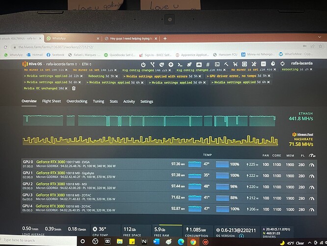

Hey guys I need helping trying to fix this high negative Hashrate
these are my over clocks and I also want to know why it shows that I have one worker inactive
use locked core clocks instead, offsets just burn more power than needed. and change to 100% fan speed to keep them from thermal throttling.
for non lhr 1080-1100 core, and as high on the memory as is stable.
for lhr, use ~1200 core.
Ok I did what you said, I’ll wait a full day to see if works. Also do you know why it shows that I have 1 inactive worker ?
Do you have an inactive worker? Did you change the name of your worker?
No, I only have that worker
And did you change miners or the worker name? Look at what your inactive worker was called and see.
Hey man I did what you suggested but nothing has changed
There’s anything else that you can suggest ?
