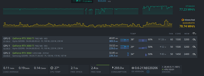

Can you post a screenshot of your worker overview screen?
This is now with 125 125 110 power limit … however without power limit it is same or even a bit worst. Soon I will upload a screenshot without power limit too.
Thank you
here it is…
as I’ve mentioned… Ti cards are quite “unstable” jumping up and down… but after a while… % is 60 !!!

Other question: How does it work when LHR % decreases but Mh/s increase? Shouldn’t be in other ways around? If no power limit, LHR detected lots of time and LHR % from 68 decreases but Mh/s is go up 42ish.
I am not getting this just like I do not understand why my cards doing this craziness. I would be so happy if they just would do that 3060 or other people 3060Ti. :frowning:
