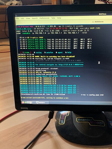

Rig with 6 3070 TI can not start to mine .Even with 5 cards it can not manage to start mining

Finish setting your core clocks, then open the miner in shell and see what it says

I think I found the reason : there is only 2gb ram ddr3 on the board…could it be the reson?
most likely. i would use at least a motherboard from the last 6 years or so.
it is asrock h81 btc pro I took it only because its stable…anyway…we will see tomorrow
I have msi 3070ti gamingX and that card cant go higher than 2400 mem while my other MSI 3070ti ventus can go up to 3000 Mem. gaming x wont run if u set higher than 2400 mem. Try lower mem.
Adding ram worked!!! Thank You guys. Now I am starting with OC
