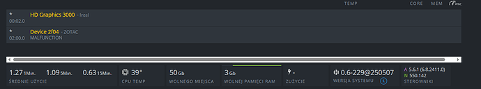

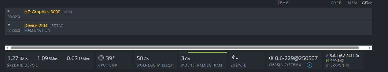

Hello, I have the same problem with the RTX 5070 card, I have already updated hiveOS to the latest version as well as the drivers to the latest version
50 series require 570.xx or newer drivers
after installing drivers 570.144, the card is visible in the system, thank you very much

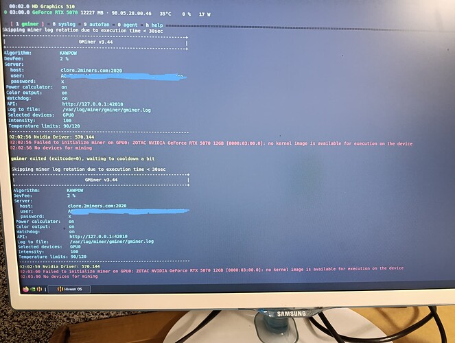

I have one more problem, I can’t run the miner on the rtx 5070 card, I should add that previously I had an rtx 3060 to test and everything worked fine
Gminer has not been updated since 50 series was released, please try another miner
It didn’t say support 50 series already
