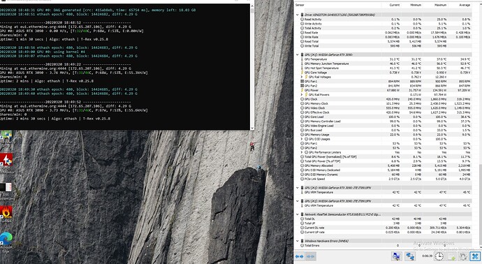

thanks keaton, i really appreciate your help as im rather desparate. i have taken two screenshots that im hoping something will catch your eye, one is without load (miner not running HWINFO 64 up) and one with the miner running, do you see anything ?
last picture is without load, first is with miner running. praying that something jumps out to you
expand this section, it will show you what’s throttling you.
does something jump out to you ?

That is while it’s mining at 3.74mhs - i have not tried moving or locking core at 1200 but i have tried 3-400 hundred both negative and positive on mem clock and core changes nothing. But what i think is incredibly strange is that rog strix oC is supposed to have an option to go 120% power in afterburner - all my other cards had the option same test station this one dosent.
