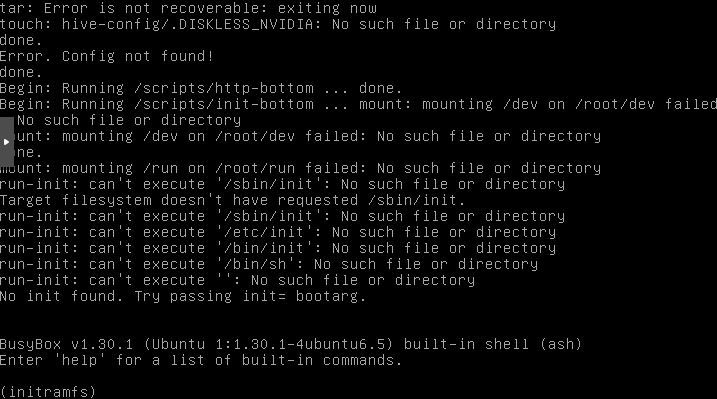

I also just tried to running the new(er) deploy_pxe script, with sudo ./deploy_pxe ubuntu20 --build and then also ran sudo ./deploy_pxe nvidia --build 550.120 and this is the error message that I get when I tried to boot up my system, over PXE:
Any help, in regards to this, would be nice.
Thank you

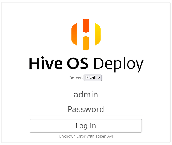

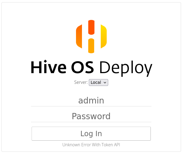

Has anybody tried to use the clonedeploy for PXE boot or use the older pxe-config.sh scripts recently?
I tried the clonedeploy instructions from this link and I get this “Unknown Error With Token API” message:
I’ve tried re-running sudo ./install-ubuntu.sh -f a bunch of times already and it didn’t work.
I also tried to use xz to extract [email protected] and then use dd to write the image to a separate drive, but it says that it’s not a bootable image.
Any help to get me back up and running would be great.
